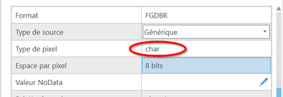

Hello,
I'm using arcpy to reclassify two rasters. The first one is reclassed with 10 consecutive intervals of 1 km. The second one in 3 intervals of asymetric values. The first outputs a raster with char pixel type (but I reclass it with interger number) and the second outputs a 16 bits unsigned pixel type raster.

example of result properties
Why would I get a char type output for reclassify? How can I force integer or at least number based output?

Well I was misleading. I thought my problem was the raster pixel type, but my real problem was actually coming farther down. After the reclassfications, I had another line of code which was basically multiplying my 2 rasters via a raster calculator. It turns out the expression received in the calculator passed the variables (rasters' name) as text instead of actual raster objects. Hence the error <can't multiply sequence by non-int of type 'unicode'> which triggered my question.
