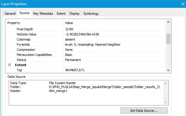

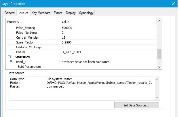

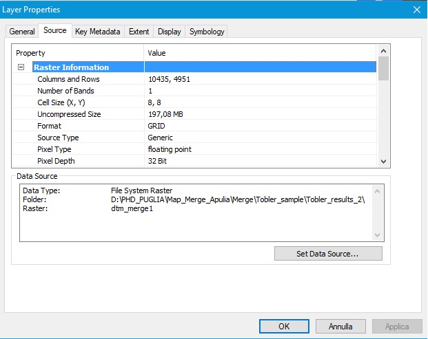

I attached some specs on my DTM and PC (you have to consider that the HD subdivision in which is installed ArcGIS has free 95.4 GB on 372GB (276GB used); while the second one 487 GB free on 537 GB (49.6 GB used).

So your raster has 10,435 * 4,951 = 51,663,685 pixels and usig a pixel depth of 32 bits (4 bytes per pixel) results in a raster of 197.08MB. This is really not very big considering the fact that I have processed rasters in the past with a size of 30GB (although I did use SSD drives for fast IO).Also have a look here: FAQ: What is the maximum size a raster Grid can be?
You are using a Esri Grid raster and a path that is pretty long and it might be good to make the path shorter (see storage limitations in this topic: Esri Grid format—Help | ArcGIS Desktop ).It might also be more efficient to work with a raster inside a File Geodatabase. If tools are not working, there might be something wrong with your data.
