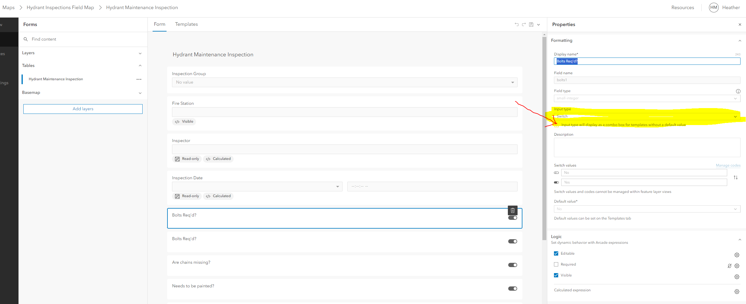

I have additional fields in my inspection table that are not in the original solutions and I am having quite the time trying to add them to the Hydrant Inspection Field Maps table form while ensuring the yes/no toggle switch works. I have tried to make sure my original fields have defaults activated etc. but when I add the fields into the form they always revert to a combo box instead of the toggle. Any advice?

Adding the new field and setting the default in the Template section in Field Maps Designer fixed the issue!
HMarcks
Thank you!  I was not aware of how to get into the Template (I believe I was viewing it from Map Viewer forms) and was going in circles trying to get this sorted out.
