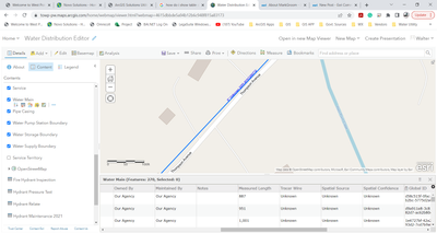

Created a layer label for a water line that would show size, make, and length.  I successfully changed the decimal location in the table but this does not change the label.  I have the same outcome in both AGOL and ArcPro.  What am I missing here?
JesseWickizer
Label the feature with an Arcade expression, and in that expression use the Round function to control the number of decimal places to show. Example label expression:
Round($feature.MEASURED_LENGTH, 0)
