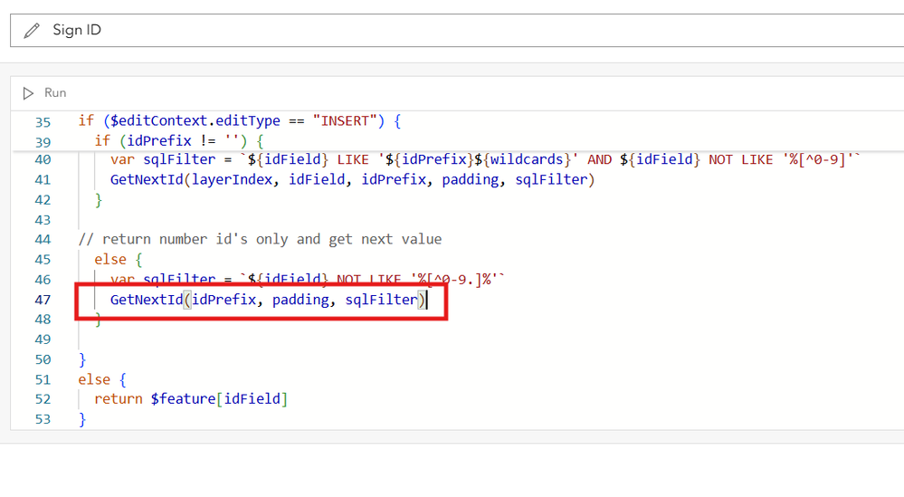

We are in the final stages of deploying the Sign Management solution to our organization and are running into an issue with creating/editing points in Field Maps. As part of the solution there is an Arcade expression to calculate asset id's using wildcards and sequential values. We have made no changes to the Arcade expression from the solution, and it works perfectly fine using the Sign Editor Web Experience.
However, when trying to create/edit points in Field Maps the asset id field is flagging as "Failed to calculate" and will not let points be submitted. This asset id field is not a required field so I am not sure why it is preventing field staff from collecting points, even if there is an issue with the expression? The arcade expression is included below:

Andrew_Eaton
There is a syntax error in the final else statement in the arcade expression, In the latest update Field Maps introduced more rigorous checks for syntax errors which is why this issue is cropping up now.  It's a quick fix.
Replace the code on line 47 with:
        GetNextId(layerIndex, idField, idPrefix, padding, sqlFilter)
This syntax error has been corrected in the solutions app so any new deployments will have the correct code.
Let me know if you have any issues.
