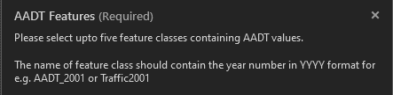

This error message is generated during  Task 3: Create roadway segments.  To resolve the issue, we need to ensure we have renamed our AADT feature as shown below:
