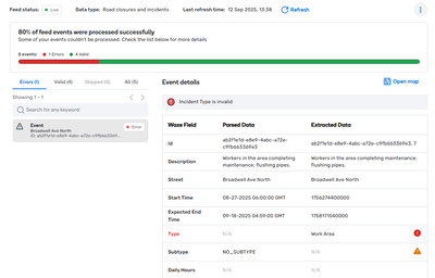

I deployed Road Closures for our organization so we could use RC schema to feed Waze. There's a push to use Waze in our area.
During testing I found an error in the Waze Partner space. The "Work Area" value is not accepted by Waze, it appears, but I'll be honest that reading an xsd is not something I have a great deal of experience doing. I'm not sure at this point if I should update the domain list in the ESRI solution (what else will this break?) or try to add the subtype information that Waze might be looking for. I had a support ticket with ESRI about the solution and they were very specific about schema changes and not making them. I've made several because we need them. I cannot 100% redesign our product for our smaller community, the change needs to happen more slowly. We are only using the feature service (and related view) in our local solution, so I don't care if the map and ExB part of the solution don't work, I've got my own solutions there, but I want Waze to get the data we are sending.
Has anyone else found this? Any suggestions on getting this to work? Maybe I'm missing something basic?!
Updating the feature to a "hazard" does not fix the error in Waze. Hazard is in the solution and Waze xsd.

Where did the value "Work Area" come from? We have been using version 2.0 of the Road Closure solution and the only types we have are Construction, Event, and Hazard. Esri changed the data schema from version 1.0 to 2.0 and it is no longer compliant with Waze's schema. The only automated way to use Esri's 2.0 solution and have a Waze Feed is to create another feature service with a schema that matches what Waze requires and then create a python script that translates the Esri data to the Waze schema. Then schedule the script to run at a specific interval.

I think "Work Area" one of my testing values - so my mistake on the post.
It still doesn't make sense that Hazard doesn't work.

Waze is expecting a "type" field and a "subtype" field. The "type" field value for road closures is always ROAD_CLOSED, and the subtype field is going to be either ROAD_CLOSED_CONSTRUCTION, ROAD_CLOSED_EVENT, or ROAD_CLOSED_HAZARD. The values are all caps and underscores for spaces.
The version 2.0 of the Road Closure solution changed the "type" field to "reason", got rid of the subtype field, and changed the "reason" values to "Construction", "Event", or "Hazard". That is why Waze does not recognize the input anymore. If you want to use Esri and Waze while only editing one feature service, you will need a Python script that extracts, translates, and loads the data from the Esri format to the Waze format.

It works, in a limited capacity.
Waze only reads our closures as construction. I can submit 'Construction' 'Event' and 'Hazard' now to Waze without getting errors, but Waze shows all events as Construction. I put in a ticket with their support and the response was basically that they'll report our data how they decide is best. 🤖
We are still using those three categories/domain values because we are using the Solution with Community Map (and Community maps does take the other values).
