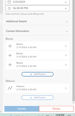

In the Road Closures app if you select an existing road closure line to edit the feature you can scroll down to the bottom of the form to view and add related road blocks and detours:

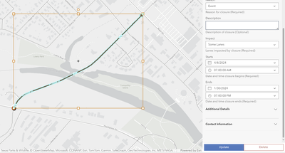

@ChrisFoxI am not seeing a Blocks or Detours section in the editing form in Experience Builder or Map Viewer.

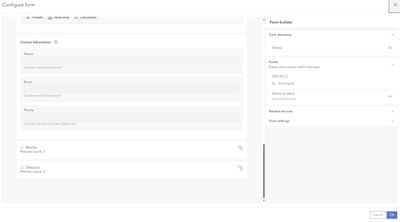

They do show up on the Configure Form page in the web map
