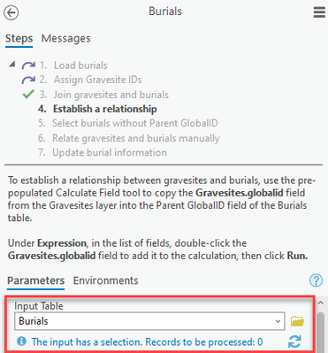

Dakota
I just got it working.. Solution was a facepalm but I just need to close my attribute table. Even though nothing was selected in them, a row was being highlighted somehow is the best guess I have.
DanielWickens
@Dakota - sorry to hear the tasks were hard to follow. I am aware that sometimes the tasks automatically make a selection of no records (see screenshot below), and that can cause issues with running the join/calculate.
Opening the attribute table and either switching the selection or choosing a manual selection should fix the issue.
If there are any other issues you're experiencing with the Pro tasks or overall solution, please let me know and I can log them as issues to fix in an update. Thank you!
