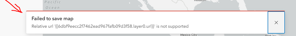

I downloaded the Parcel Value Analysis solution which comes with an "Equity Analysis" web map. When I open it, I see that the Foreclosures and Appeals layers have an error message under them saying "An error occurred loading this layer." If I try to save the map (after making no changes), I get an error message saying the following:
Failed to save map. Relative url '{{GUID.layer0.url}}' is not supported
Do you know what's causing these errors and how to fix them? Thank you

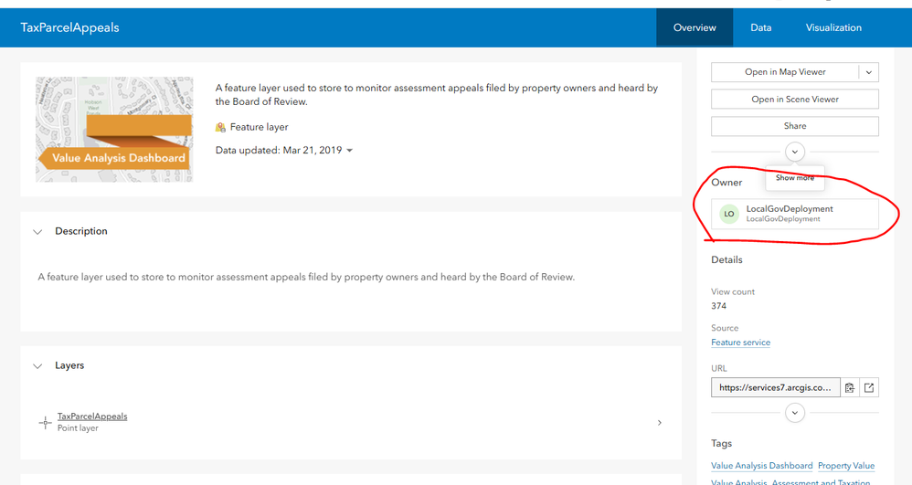

When I try to click on the layers - either from the ArcGIS Online Overview page or within the Web Map - there is no information about where they're being sourced from. However, in the original error message I was able to look into that GUID (6dbf9eecc2f7462ead967fafb09d3f58).
It takes me to a Tax Parcels Appeals feature service that has a different owner and is NOT the one associated with my deployment of the solution.
Tax Parcels Appeals - Feature Service.PNGTax Parcels Appeals - Feature Service.PNG
So my guess is that this is what's causing the error message. However, I don't see a way to re-point the existing layers in the map to the correct feature service. Do you know if there's a way to do this? Or would I need to remove the layers then add (and configure) the correct ones?
