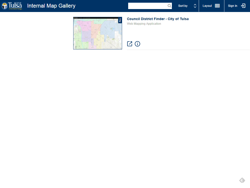

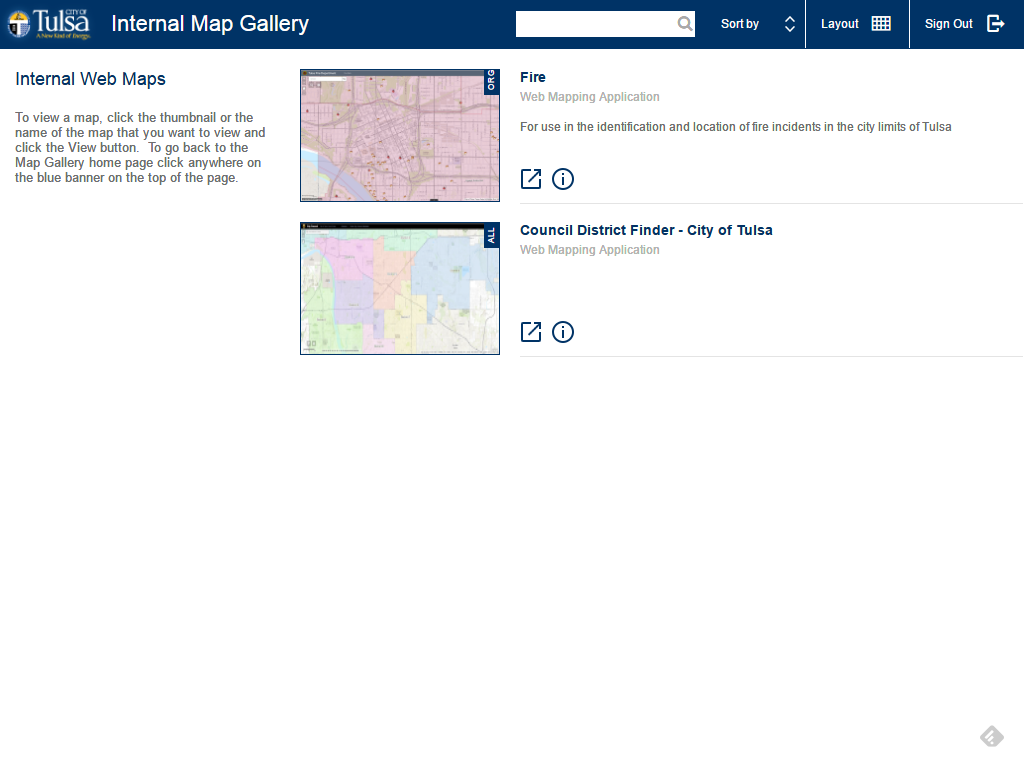

In AGOL we configured an Internal Maps Only group. We shared an AGOL (currently private) map with this group and one that was public. At this point the public map shows up but not the private. We noticed that if we signed in, then it works perfectly. This Internal Map Gallery is supposed to be for INTERNAL USERS who may (or may not) have AGOL accounts. So we need this app to work regardless of who is accessing it because ONLY Internal users can even see it.
This is what we see when we visit this map. But if we login, we see the following:
I can't require users to login. Most users have no clue what AGOL even is.
