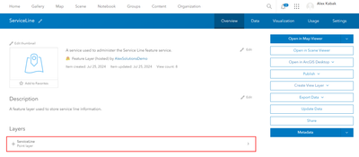

AlexKabak
Yes, your source and target url's are ending in FeatureServer when they should end in FeatureServer/n, with n representing the layer id. If you are copying and pasting the url in, ensure you are doing so from the layer. An easy way to get there is by clicking the layer on Feature Service item Overview page and copying the url from there. I have attached an image highlighting where to find the layer.

RichardFreer2
Thanks again Alex, that solved the issue.  Have a great week.
