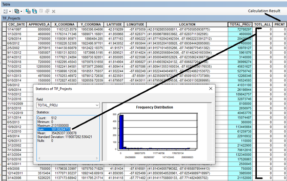

Hello,
I am attempting to create a field that shows the amount equal to the total of a specific attribute (as a reference denominator field) to calculate the percentage of the total of each record in a separate field
I did attempt to summarize, but this only created a table with one field of the total. I see that I am supposed to join the data back in with the original data but how do I do this if there is only one field? Can you populate a whole column with one join?
I hope this makes sense and thank you to anyone who is able to help!

A couple things to consider:
1. What Type of field is PRCNT?  I'd make a float.  My bet is you have as an integer, and that  type of field can't handle decimal places that you will have.
2. I always use Python expressions so it would look like :
!TOTAL_PROJ! / 1813828471
That just gives you a rational number.  To get true percent:
(!TOTAL_PROJ! / 1813828471) * 100
That should just about do it....

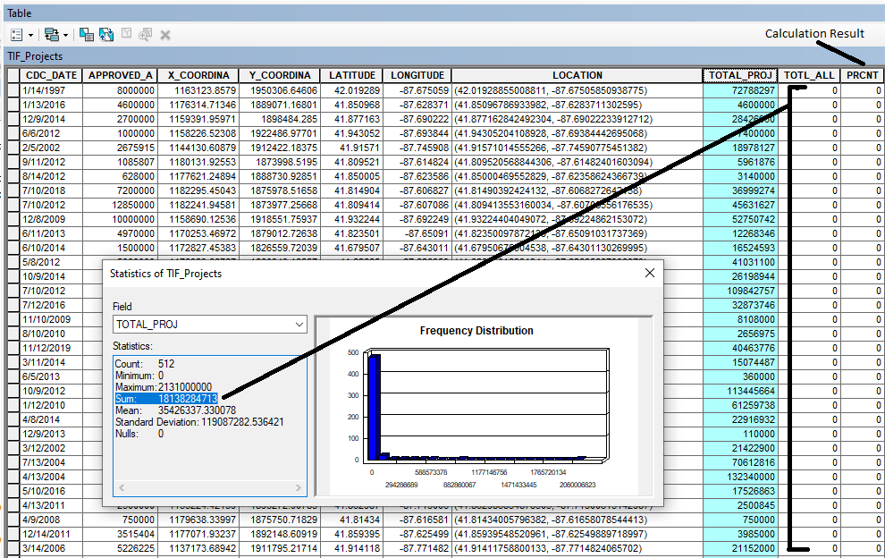

JenniferGoldman
I keep entering into my PRCNT field with the calculator:
PRCNT = [TOTAL_PROJ] / 1813828471
but it keeps giving me 0 (I tried playing around with the numeric display by adding decimal places, but still no go)
JenniferGoldman
Yes! That did it. I was using a long integer before and even caught on to what you were suggesting during my own troubleshooting (I started setting the precision to 100,000 as an experiment, but perhaps that was not even enough! Better to do a Float now when unsure I suppose).
