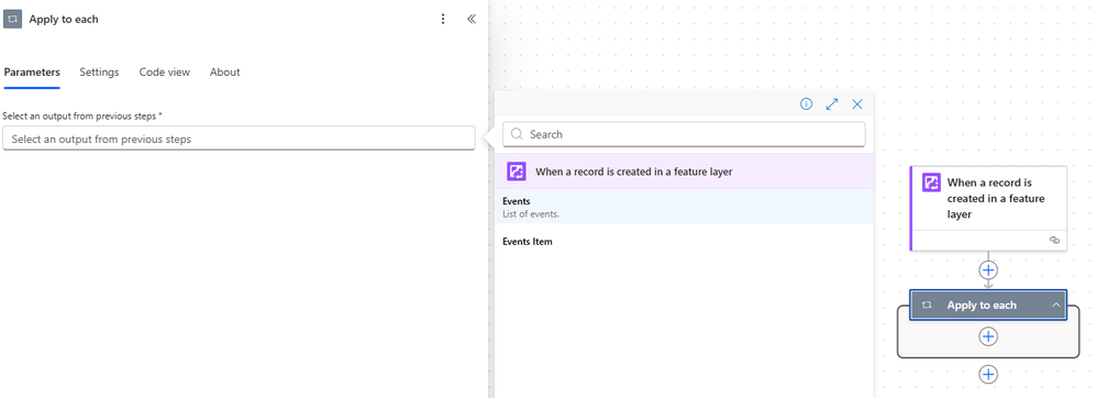

Hi,
I am trying to configure the Request Management Solution to send emails with Power Automate but have run into an issue setting up the flow. I am following the instructions at https://doc.arcgis.com/en/arcgis-solutions/latest/reference/configure-gis-request-management.htm and at step number 19 it says to click Body as the output from the previous step. I do not get the option for Body, all I see is Events and Events Item.
I have the Power Automate premium licence and my connection to ArcGIS Enterprise all seems to work. Can anyone suggest what I might have missed?

StephenKing3
Hi @DanielWickens, I am using the Enterprise connection - I don't have the solution installed in ArcGIS Online. I've attached a screenshot of what I am seeing. Thanks!

StephenKing3
@DanielWickens yes, I can confirm that I have followed those steps. I have also tried setting up the ArcGIS Enterprise Connector before beginning the flow and during creating the flow and get the same result. For the GIS_Activities and GIS_Requests, I have both of those properties enabled, although 'Keep track of changes to the data' is greyed out (but enabled). I have tried re-enabling but this hasn't made a difference. Thanks again.
