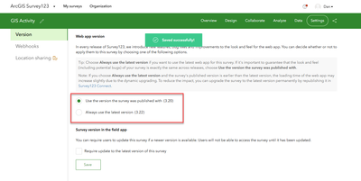

Turns out the issue is indeed related to using the 'version=latest' URL parameter. By default, we set the GIS Activity survey to use the latest version of Survey123 (3.22), and that is causing the loading issue.
In the survey's settings, you can change the web app version to use the version the survey was published with (3.20). You can then remove the 'version=latest' parameter from the URL completely, or hardcode 'version=3.20' if you've already republished the survey using a later version.

UPDATE (2/28/25):
I have an update and a much easier way to fix the issue while also keeping the field:manager=Yes paramater in the URL.
Please give this a try, and let me know if it works for you.
