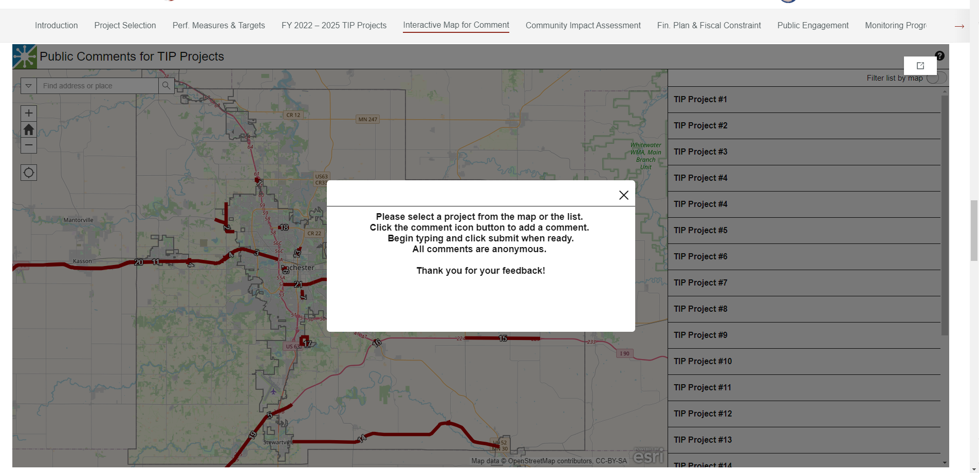

In a StoryMap, there is an embedded Crowdsource Polling Application. When the comment icon is selected, the StoryMap auto scrolls past the embedded application and then the user has to scroll back up to continue adding a comment. Not terribly helpful! Any one know why this is happening? Is this a bug?
StoryMap is public, please don't add comments! (Unless they may be helpful to our community 😉 )
https://storymaps.arcgis.com/stories/aa8355242c8646b0bb93b719d12f3ed4
Original View:

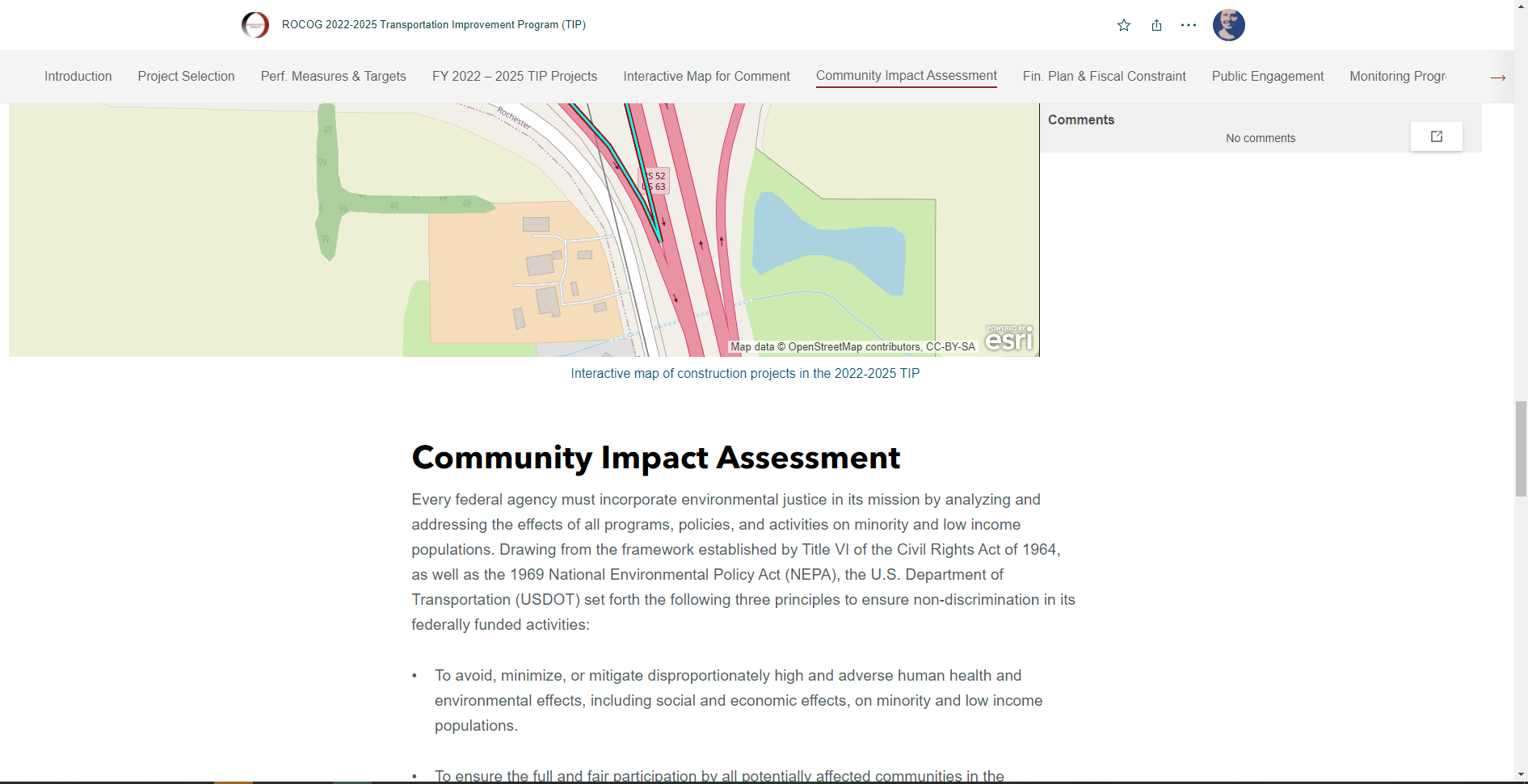

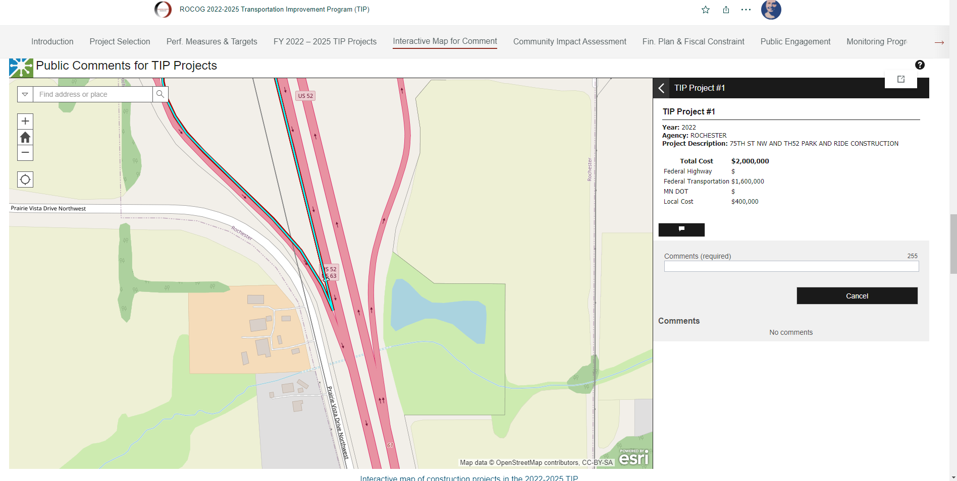

Click in side panel in application: StoryMap Scrolls half way down

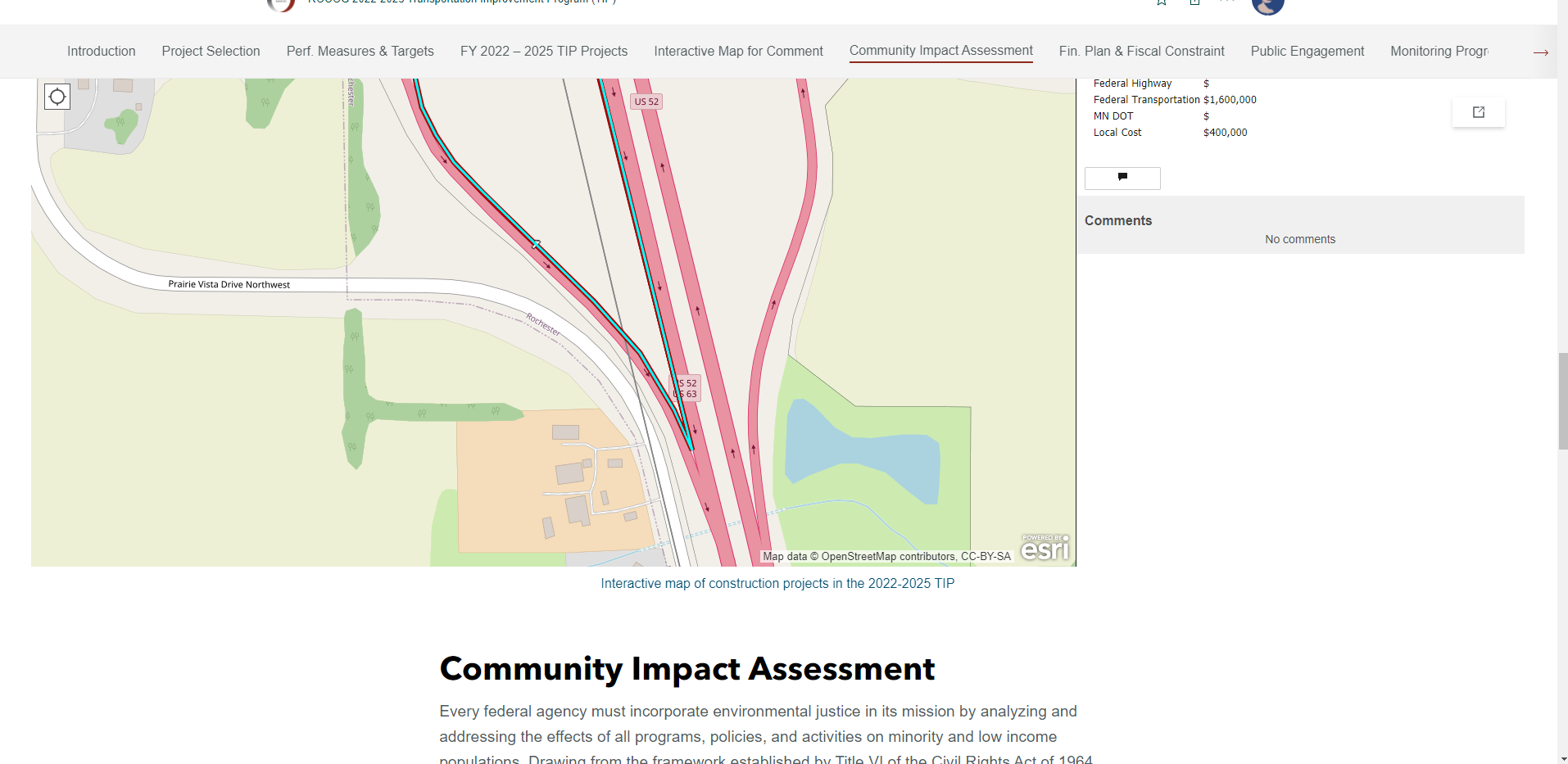

Click Comment Icon: Bye Comment Box!
How it should display the whole time:
This happens at each size! So it's not a size issue. Help!!
