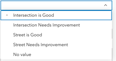

Both the Other and Recommended cause unnecessary confusion on users.
Selecting a value from Recommended or Other just tells the user they have selected an invalid selection, based on the previous selection.
It seems way better to not have the option to select Other or Recommended, it's only a hinderance, absolutely no benefits that I can see.
Can No Value be removed, maybe by not allowing Nulls?
No Value selection on a User Submission only causes errors, I don't see a value in anyone selecting No Value
