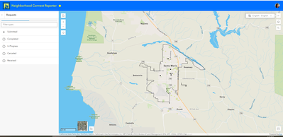

With regard to the form only showing the legend, my guess is that the feature layer now has multiple editing templates and it is asking you to select which template you want to use first. If the layer only has one template it skips this step and takes you right to specifying the location and then filling out the form. Could you share a screenshot of what you are seeing.

Hi Chris, yes, this is what is happening.  Here is the template we are seeing.
To explain, we went into the template and turned off each request type (it looked like a legend but was indeed a template).  So now it is just blank.  We need to figure out how to turn off the template altogether so we just go right to the report form. This worked before the AGOL update.

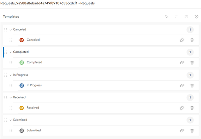

Chris, when I look at the Requests layer, I see this template:
This is what we had in the requests_reporter layer as well, and what I can add back in.  When we had this in the requests_reporter layer, it came up first when we clicked on 'Submit Report', not the form itself.  Once I add the above template back in, how will I get the form to show up and not the template?  Or do I have to put the form in the template?  I'm not sure how the integration is supposed to work...

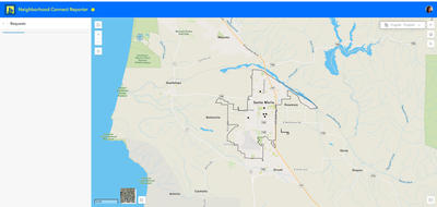

Dawn_Scott
Now that I have updated the template, with some of the info (the symbols are not right yet), here is what I get when I click on 'Submit Report' :
Why does the template come up here and not the form?
ChrisFox
@Dawn_Scott, you will want to remove the templates for every status except submitted. This is the only template you want, so that the new report defaults with a status of submitted. If you only have one template, the Reporter app should skip selecting a template and go straight to providing the report location and then to the form.
