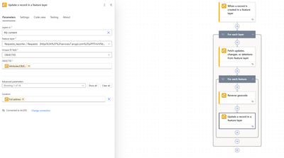

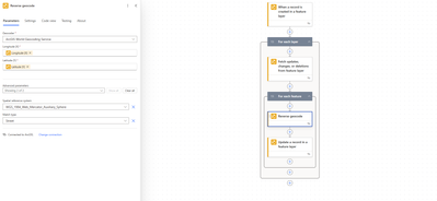

Below is a screenshot of my flow to get this working and I have highlighted the settings I use for the reverse geocode step.
Then after the reverse geocode I am using the Update a record in a feature layer action to update the original feature's location field with the result from the reverse geocode.
Hope this helps you get this implemented in your organization.

I'm happy to report that the reverse geocode process worked successfully! As we discussed regarding the email generation, the current procedure requires using the new Power Automate designer versus the default one.   Once I had that up and running, I was able to insert the reverse geocoding portion using the parameters you included.  Hopefully your posts will help the original poster of this thread to make it functional with their CPR data.
