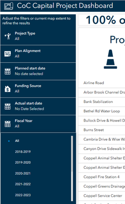

One follow up question, what is the support or use case for plural "Funding Sources" and "Fiscal Years" columns? For example, if I add multiple entries like ***"2018-2019, 2020-2021, 2022-2023" is there any responsiveness in the dashboards... For the default configuration, it has each year, but would each unique combination of fiscal years be require to support multiple years? I've included the screenshot of what the default configuration would look like with our list (***we have a fiscal year from Oct-Sept, so it spans two years) in the Capital Project Dashboard. It seems to be 1-1.

Hi Leah,
The "Fiscal Year" filter works with a contains operator. When a new funding record is generated, via Capital Project Catalog or  Capital Project Coordination, the year is concatenated into a field on the source project.
This field ends up having every year for which funding is added. When the filter is used, it simply searches that field for the year selected and then filters the data.
Simply put, you the strings in the Value column for the data options should match what the fiscal year drop down looks like in the Capital Project Catalog or Capital Project Coordination applications. This will all the dashboard to be responsive when the filter is used.
