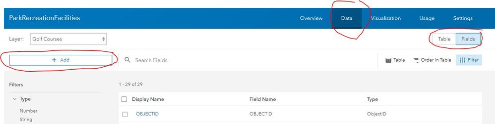

An alternate option is to go your feature service in AGOL and go to the Data tab.  There is a Fields view option, click it.  There should be Add option and you are able to add new attribute fields.
Hope this helps you.

The Append tool won't add fields to the ParkRecreationFacilities layer, it will simply populate existing fields with attributes.
If you'd like to add fields to the ParkRecreationFacilities layer and populate them with attributes, you'll need to add the desired fields to the feature layer in ArcGIS Online, then use the Append tool to populate them with attributes.
In ArcGIS Online, navigate to the ParkRecreationFacilities item page and then follow these instructions for adding the fields you want:https://doc.arcgis.com/en/arcgis-online/manage-data/add-or-delete-fields.htm
To populate the fields, run the Append tool again, using the field map to match up the desired fields.
