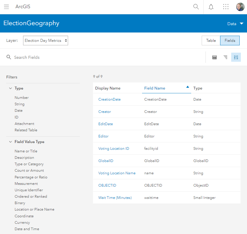

With the help of ESRI's Matthew Twietmeyer I've deployed the election Management Solution and need to add a field to the ElectionGeography hosted feature layer (Election Day Metrics table).   I am the owner.
I open the item details, go to Data, and select the Election Day Metrics table.
In both Table and Fields views I see no "Add" functionality as described here:
Add or delete a field—ArcGIS Online Help | Documentation
Strangely, I am able to add a field to the ElectionResults hosted layer (ElectionResults table).
Any tips on how to accomplish this or why I don't see what I'm expecting here?

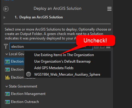

Strange... none of the feature layers are "hosted". Something may have went wrong during the deployment. Can you try deploying a fresh copy to see if the issue persist? To deploy a fresh copy:
  1. In ArcGIS Pro, click Share > ArcGIS Solutions.
  2. Click the hamburger icon and ensure that "Use Existing Items in the Organization" is unchecked.
3. Select the solution and click Deploy.
4. Navigate to the Item Details page of the new feature layer. Is this new layer hosted? If so, are you able to add new fields to it?
Please let me know if you have any questions regarding this workflow.

They all appear hosted from here:
And the URL of the Election Geography appears to be hosted:
https://services.arcgis.com/iCGWaR7ZHc5saRIl/arcgis/rest/services/ElectionGeography/FeatureServer
