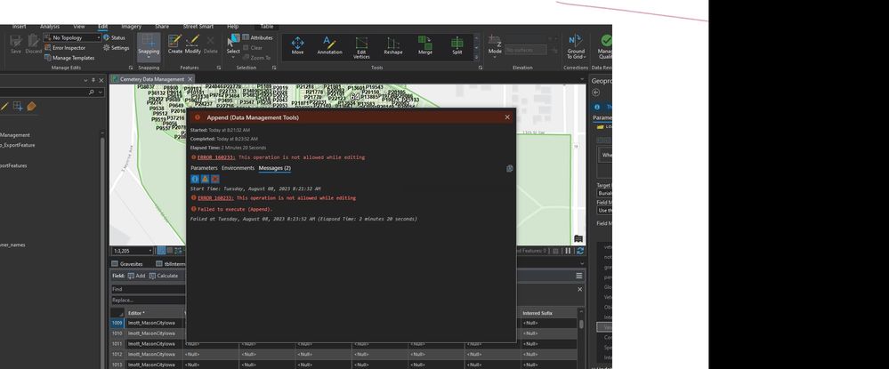

@Laura - Do you have screenshots of the errors you're experiencing?
Laura
by MVP Regular Contributor
Laura
I have logged a bug for it
  • Bug Number: BUG-000160479
DanielWickens
Thank you @Laura, I will keep an eye on the progress of the bug. I have not come across that error in ArcGIS Pro before, and the help documentation about it is sparse. https://pro.arcgis.com/en/pro-app/latest/tool-reference/tool-errors-and-warnings/160001-170000/tool-...
I am curious to see what Esri Support uncovers.

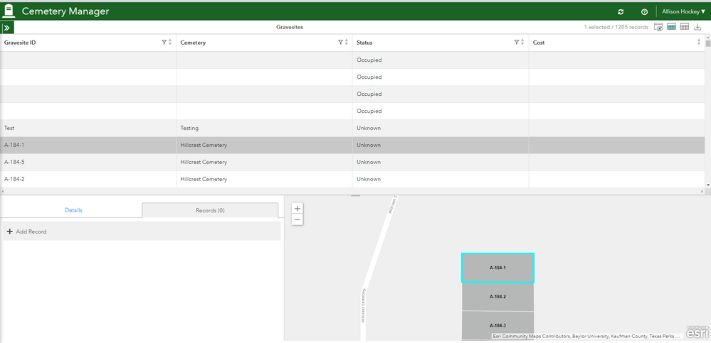

So, I've done a bit of extra configuring on the Cemetery Manager application so that it includes an additional web map I made specifically for reconciling unresolved issues that only the cemetery manager can. I've called my map 'outstanding issues'. Take a look at the screenshots:

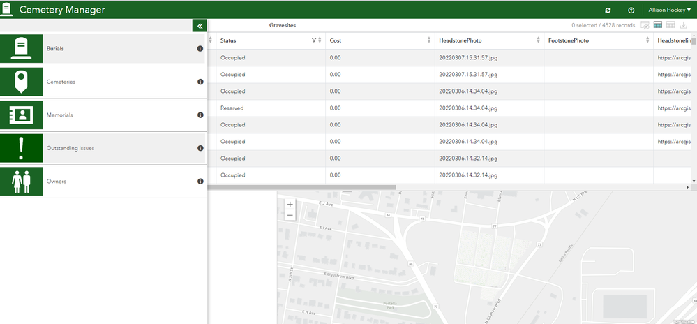

This is the Burial web map.
There are only a few fields showing. This is what I'm trying to accomplish in my 'outstanding issues' map. All of the fields are showing. How can I get it to only show a few like the burials map?
DanielWickens
@Allie - You need to configure the attributes in your Outstanding Issues web map. Open the web map in Map Viewer Classic, then select the feature layer and click "Configure Pop-up". Then click "Configure Attributes". Check the fields you want to display and edit. Select a field to change its alias, order it, and format it. The fields you set to Display are shown as columns in the Manager app. The fields you set to Edit are editable when you select a record in the Manager app. Here's a screenshot from the Burials web map for reference:
