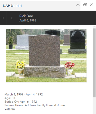

@Allison_Hockey - When photos are attached to the gravesite or burial features, they are presented in the pop-up for apps such as the Cemetery Dashboard and Cemetery Viewer (see screenshot below).
Are you also asking for a way to store the URL of the image file as a field in the feature layer? Is there a specific reason why you want to do this?

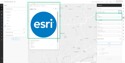

@Allison_Hockey - You can try adding an "imageurl" field to the Gravesites/Burials tables. You can then create a CSV or XLSX spreadsheet to append the Amazon Bucket URLs to that field based on the unique ID (e.g., ObjectID) of each feature. You will need to match up the ObjectID with the Amazon Bucket URL in your spreadsheet before uploading. Once you have your spreadsheet ready, you can use it to append and update features using the steps outlined here.
If you've uploaded the data correctly, each existing feature will have the Amazon Bucket URL in the "imageurl" field. You will need to update the hosted feature layer views that are used in the maps and apps to show the new "imageurl" field you added. Once you've done that, you can update the apps to use the "imageurl" as the image source in the pop-up, instead of using the feature's attachments. See screenshot below as an example:
