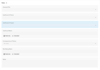

Apologies for the delayed response. I approached this by creating a group within a Field Map Form.
I then have a drop down for which part of the tree is being assessed (Roots, Branch(es), Trunk, Whole Tree).

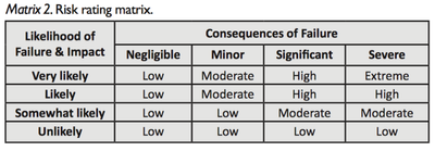

The next drop down is for the different options (Imminent, Probable, Possible, Impossible) from the Likelihood of Failure matrix (Matrix I)
A third drop down follows. This drop down is for the Likelihood of Impact (Very low, Low, Medium, High). These are also from Matrix 1 (above).
A fourth field is calculated and read-only. This field calculates the middle portion of Matrix 1 (Unlikely, Somewhat likely, Likely, Very likely). The code for this field (which could be optimized) is as follows:

The next field is another user selectable drop down. This one addresses the Consequences of Failure portion of Matrix 2. The values of the drop down are Negligible, Minor, Significant, Severe.
The final field is another calculated field that utilizes the last two fields to determine the risk rating of the assessed part from the first field. The arcade for that (which could also be cleaned up) is as follows:
