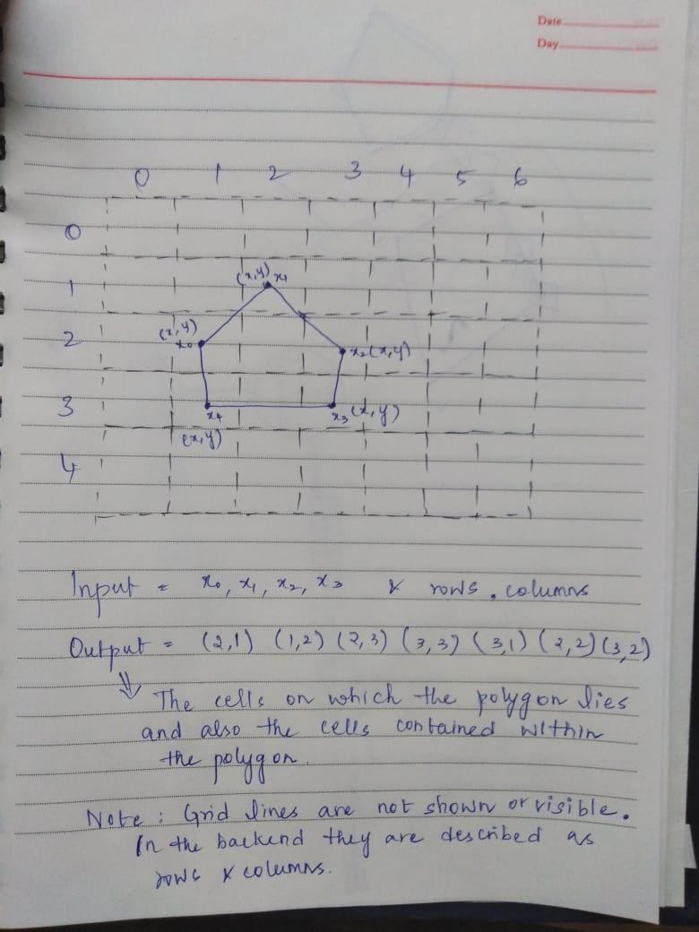

I have divided the map into rows and columns at the backend using the extent height and width of map  (arcgis api for js) and i have a set of polygons on the map.  Now i want to know the cells(rows and columns and each cell size be 500mx500m) at which each polygon lies and also the cells contained within the polygon.  Note that the rows and columns are not visible on the map. I need the java code to find this.  Can anyone help with this ?  Thank you in advance

Yes, I have polygons are visible on map but cells are not visible on the map, since i have divided the map at the backend. i have attached the image.  Dotted lines indicate that they are not visible on the map and i have described about the input and output. If there is need for clarifications regarding image, please let me know.

Sorry.  I'm not getting your point.  If the cells are not visible then how can I find that they intersects are not ? And one more thing I'm new to GIS related projects.
