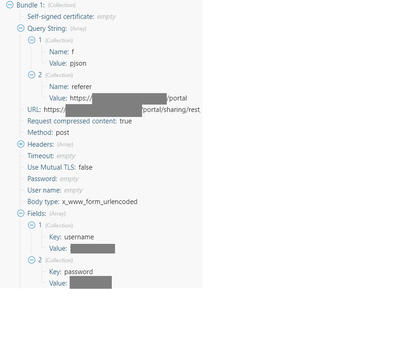

StrathconaBTS
I also ran into this. I included the username and password in the body of the request instead of the header and that solved the issue!
EG
