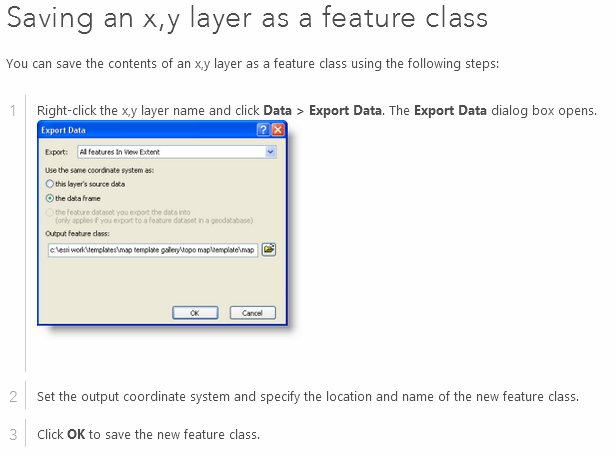

As Chris mentioned, you will need to make is a shape or feature class.  An event table is just a temporary view of the data.
Adding x,y coordinate data as a layer—Help | ArcGIS for Desktop
...If you want to be able to perform these <<or pretty much any task..my comment>>tasks, you can export the x,y layer to a feature class using the steps below or follow the steps above to use the Catalog window to create a feature class from an x,y table....
