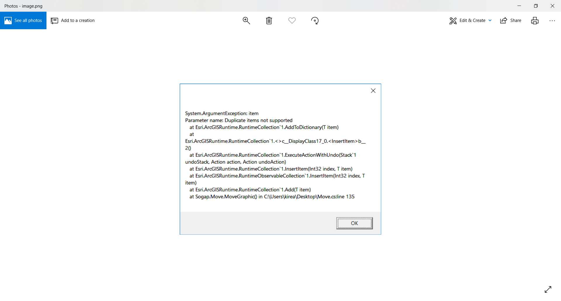

This is function for reading gml file from zip archive. Application work OK for gml file with several graphics.When load gml with more of 100 graphics applications is very slow and may to crash.I know that start garbage collector because in loops is initialize Graphic class constructor.
When initialize Graphic class constructor on begin of function out of loops appear next message:
How to solved this problem with garbage collector and my application to work fast?
