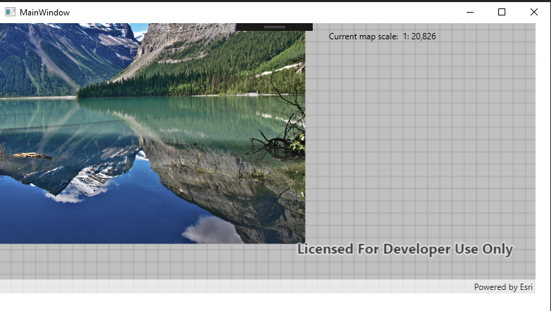

When I run an application I see image with current scale:
But I don't have a possibility to zoom out from this scale.
I really need to know if there is any possibility to zoom out when we have a nongeoreferenced map and image layer on it.
As you  see I tried to use MinScale, MaxScale, SetViewpointScaleAsync, but it didn't work.
