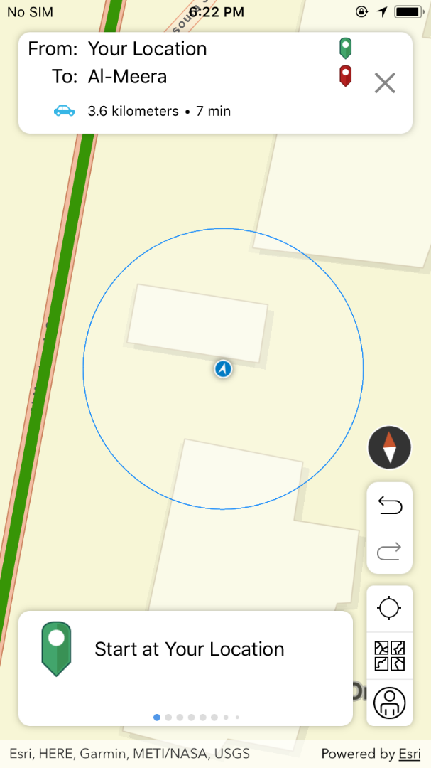

Dear All,
I was trying to test the map-app-ios with few customization from my side using AGSGeometryEngine Class to speech the direction text, after my integration i was trying to text the app how it was behaving when i am driving. Here with i am attaching 2 screenshot which i found at the time of testing the app, necessary help would be appreciate for the way forward to achieve my goal.
Also here i am attaching few code snippet how i was trying to achieve the text to speech recogniser.

But When Driving Navigation Arrow Going Beyond Map Actual Route or Road. please have a look on the below attached screenshot.
Would be great and helpful if you can suggest some trick how to test the app with Real Time Driving and Navigation.
8 Replies
ManasaParida
Any update from ArcGIS Runtime SDK for iOS‌ support team please ?
Nicholas-Furness
Hey Manasa Parida‌,
I wonder if there's some confusion about the purpose of the Maps App here?
The Runtime SDK does not offer a navigation experience (just a routing experience, i.e. we can get you directions, but you have to get yourself to your destination) and does not track you along a route that you've got planned. The Maps App doesn't add anything to that, so the fact that your location has deviated from the route, as in the screenshots above, is expected. You would need to add additional logic to your app if you want the location snapped to the route task result.
One approach might be to write your own AGSLocationDataSource that you pass a route task result to and as your data source reads updated locations from Core Location, your custom data source snaps the results to the current route, returning those to the AGSLocationDisplay. That way the map view will show you on the route if you're nearby.
I hope I've understood your question properly. I think the crux of it is that there's no relationship between the route task result that you're displaying and the device's displayed location, and that is as designed.
Nick.
