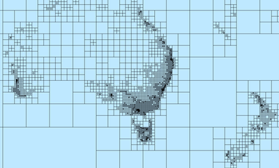

Separately, as I mentioned, overzooming is why we request data outside of the configured visible range. For example: in the Pacific, there may be no need to bake level 12 tiles for a given area when the single level 2/3/4/5 etc. tile works fine.
Tiles and overzoom for vector tilesTiles and overzoom for vector tiles
That's discussed a little more here.
