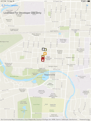

I created a similar scenario, based on your information.  It seems to be working for me, but let me know if this mimic's your situation.  The items in the list view are `AGSPopup`s.  They don't have a title, so I'm simply using the "popup.geoElement.geometry.description" as the text in the table view cell.  Tapping on a row creates a new "AGSPopupsViewController" with a single Popup and then pushes it onto the navigation stack:  "navigationController?.pushViewController(popupsViewController, animated: true)"
I'm using Xcode 14 and the iPad Pro (9.7-inch) iOS 16 simulator.
Let me know how well this matches your code; if you are able provide some code that reproduces the issue in a simple project, that would help.
