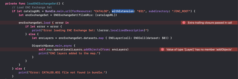

Thank you for pointing out I was not using 200. I have updated to 200 sdk. but now this code does not work.
private func loadENCExchangeSet() {
        // Load ENC Exchange Set
        if let catalogURL = Bundle.main.url(forResource: "CATALOG", withExtension: "031", subdirectory: "/ENC_ROOT") {
            let encExchangeSet = ENCExchangeSet(fileURLs: [catalogURL])
            encExchangeSet.load { error in
                if let error = error {
                    print("Error loading ENC Exchange Set: \(error.localizedDescription)")
                } else {
                    let encLayers = encExchangeSet.datasets.map { ENCLayer(cell: ENCCell(dataset: $0)) }
                    DispatchQueue.main.async {
// I am getting error here
                        self.map.operationalLayers.addObjects(from: encLayers)
                        print("ENC layers added to the map.")
        } else {
            print("Error: CATALOG.031 file not found in bundle.")
rolson_esri
Esri Alum
Why are you using a dispatch async to add the operational layers? I don't think you need to do that. Nevertheless, I don't think that should be an issue. What error are you seeing or what is failing?
ChrisPelon
