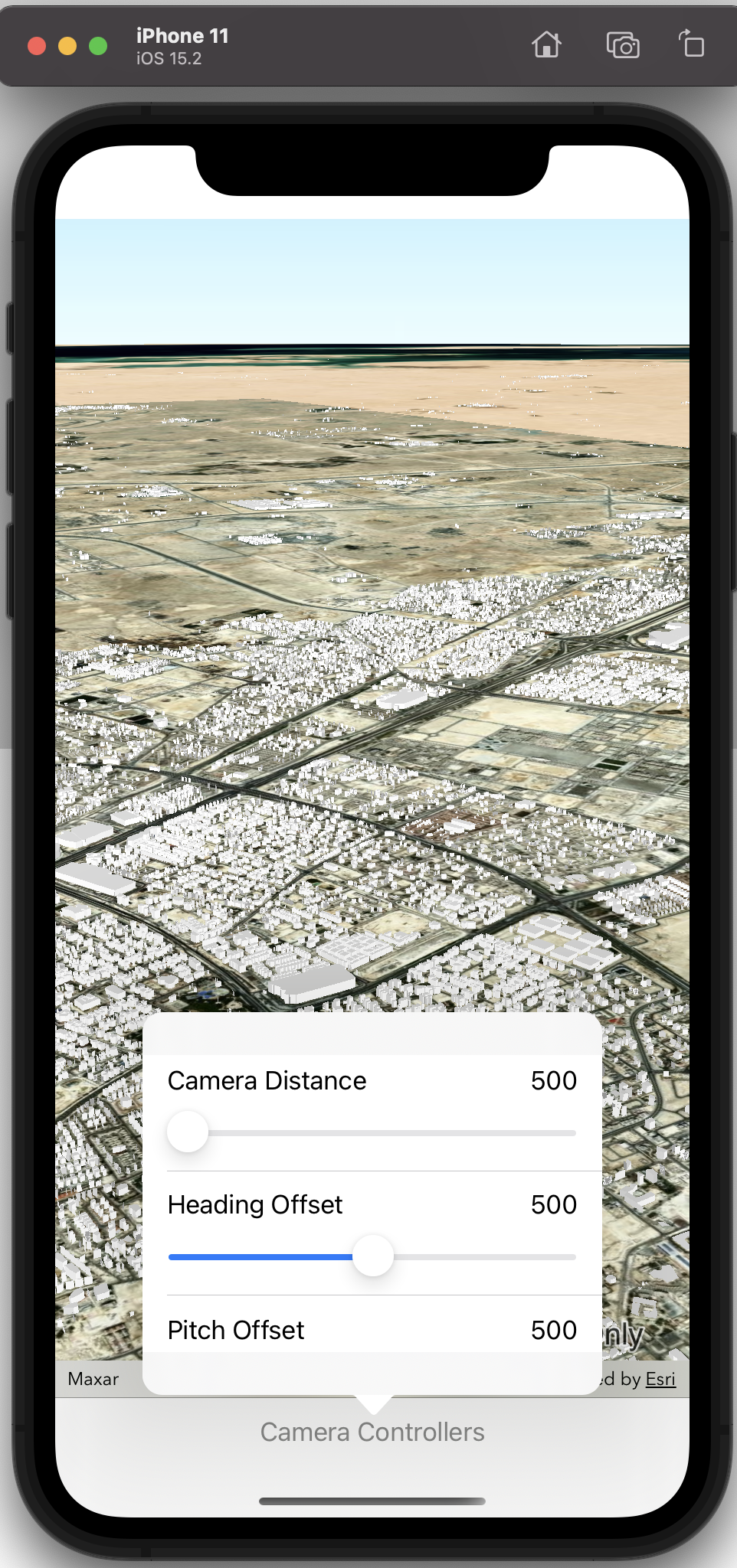

I am trying to display a 3D map using AGSSceneView and using popup menu as Camera Controller. The parameters like Camera Distance, Heading Offset & Pitch Offset are not transferring the values to its respective control. I am attaching the screenshots and Code as well.
It would be very much appreciated if anybody can help me in this regard.

Hi Afroz,
From your screenshot and code there isn't enough information to decide what is the problem.
Here are a few common things that are worth checking
  • Make sure you set the delegate and implemented its methods in the presenting view controller.
  • The IBOutlets and IBActions are correctly wired in storyboard
  • If you are passing variables/objects via segues, make sure you passed them correctly and the reference to the object is present.
  • Ensure the 2-way binding between the UIControls and their values are correct, i.e. NSKeyValueObservation plus IBAction
Hope it helps.
