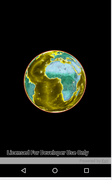

I tried to rebuilt a globe tutorial (An interactive 3D globe of extremes – a DIY mapping guide) that was created with the Web API (HTML, CSS, JS). I succeeded in creating the 'SceneView' with a Globe in it, that uses the 'TiledLayer' referenced in the article. Now I'm stuck. First of all, the colors of land and water seem to be swapped/wrong (see picture).
Secondly and more important, I didn't find a way to change all the parameters like they did in Step 2 , e.g. for the 'SceneView', they can just access and edit all paramters like background color. I think they set bg-color of the scene to transparent (alpha = 0) and applied the blue to the background of the whole website in their CSS. I tried sth. similar with the options available in the Java API, by setting the 'SpaceEffect' of my Scene to 'Transparent' and trying to color the apps background. But the bg of my Scene then just gets black and covers the apps bg. Anyone an idea?
