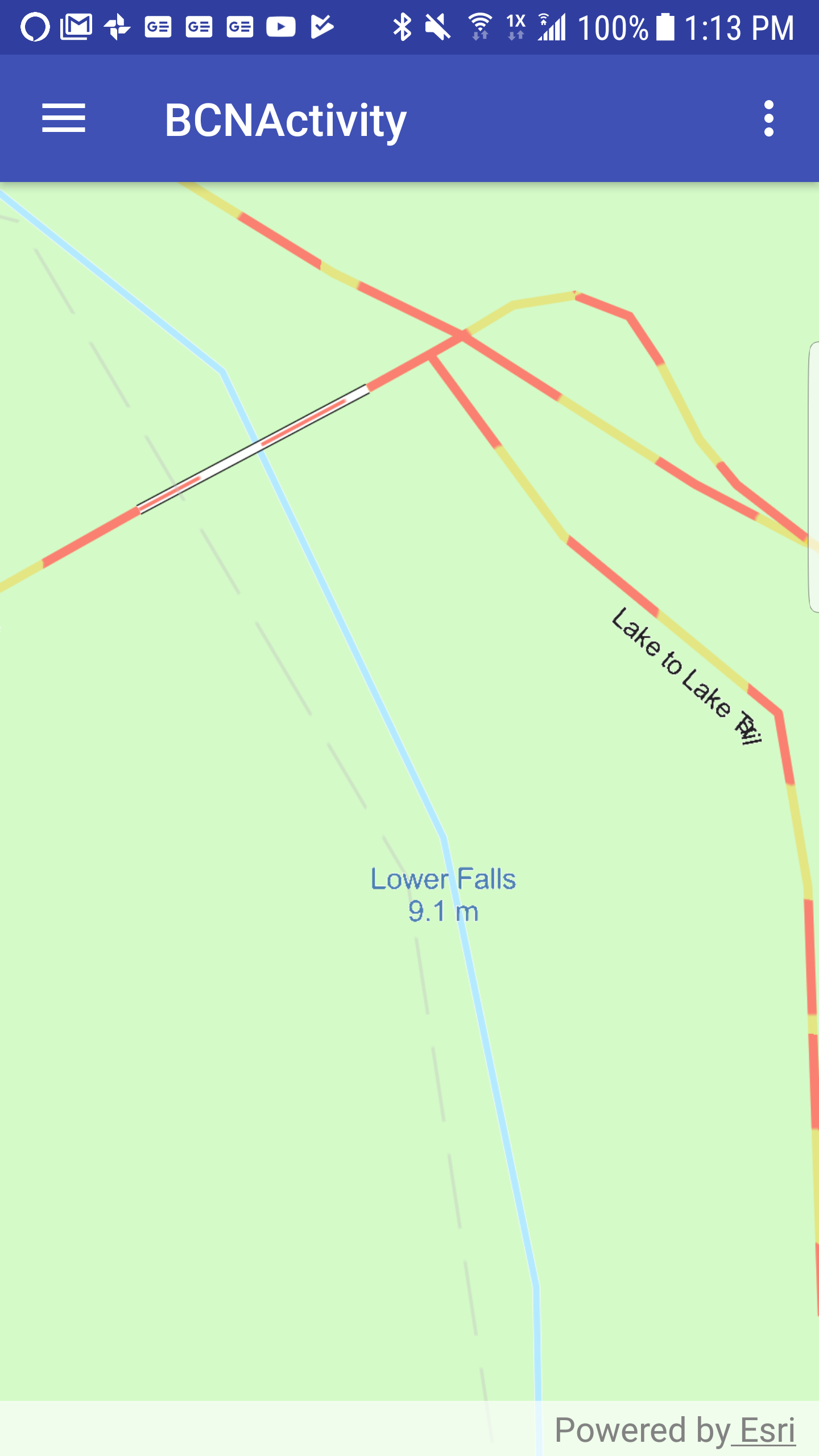

It's great that the Vector Style Editor now lets you edit symbols.
However, this doesn't work when you download them offline through the OnDemand workflow.
All the symbols are gone. Not just the ones that were customized.
Online:
Offline:
What's missing in the second one?
The tree symbols were customized in the style. They do not appear in the offline version.
The waterfall symbol is the standard one used in the Vector OSM basemap. It's not showing up either.
Looking at the download, the vtpk downloaded has four folders under resource:
fonts
info
sprites
styles
The item resource cache has a resources.zip file with only one folder - styles.
How do I get around this?
At present the only way I know of creating an "Item resource Cache". If I wanted to create one artificially, I don't know how to do it.
NathanMellor
Further, I've tried creating a resources.zip manually that will contain the sprites. It is not fooled.
Won't work at all.
Did ESRI just forget to finish writing the code for offline vector maps?
