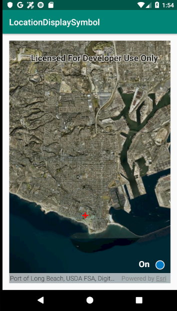

When I turned off the gps spoof app, the symbol would not display. Once I started the spoof app to simulate movement from the emulator/device, the symbol appears. Here is a screenshot below:
