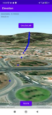

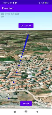

maglourenco1
Greetings,
I have some news regarding this issue.
So I have 2 DEMs, both of them are being used to perform the calculations but only one of them is being used to render the 3D surface.
The following one is working
But his one is not.
What do you think might be causing this issue? Spatial Reference?
Regarding the layerViewStateChanged, it is returning the 'World Imagery' as expected (the basemap)
Thank you
