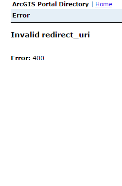

Hello Team,
I am following the below link to remove "Licenced for debveloper use only" from my mapview using standard licencing:
https://github.com/FernandaOchoa/Arcgis-Samples-Android-SDK/blob/master/StandardLicenseOffline/src/m...
I am using portal url of my app.
Outhview showing the error 400 invalid Redirect_Uri.
Please suggest?

Did you specify a valid redirect uri in the online developer console?
ArcGIS for Developers
It is a whitelisted system, so any redirect uris that you use need to be listed there.
