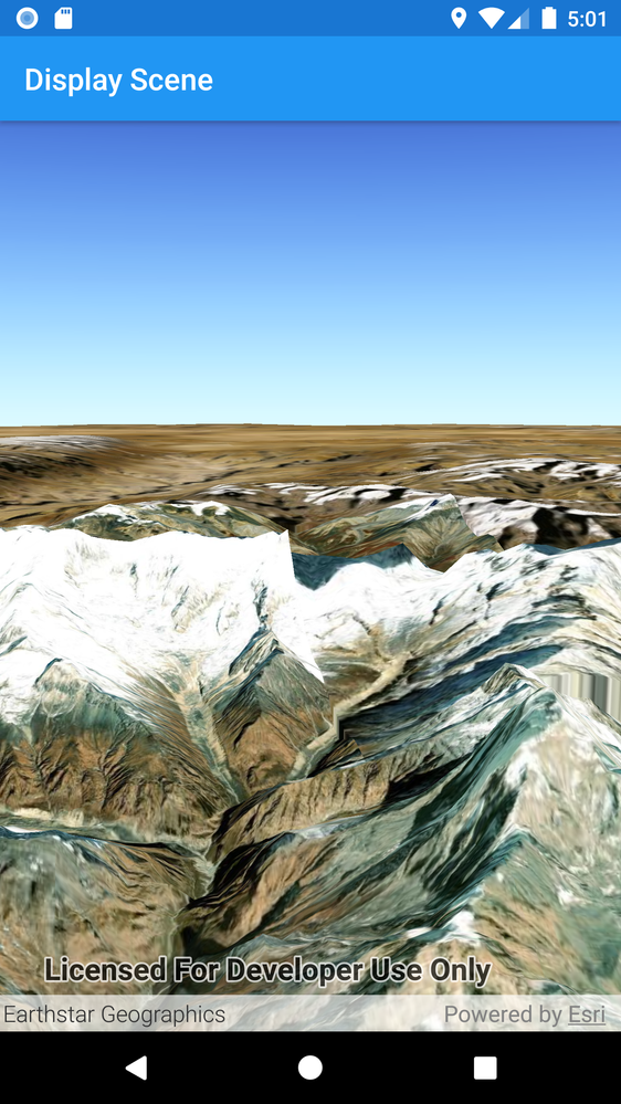

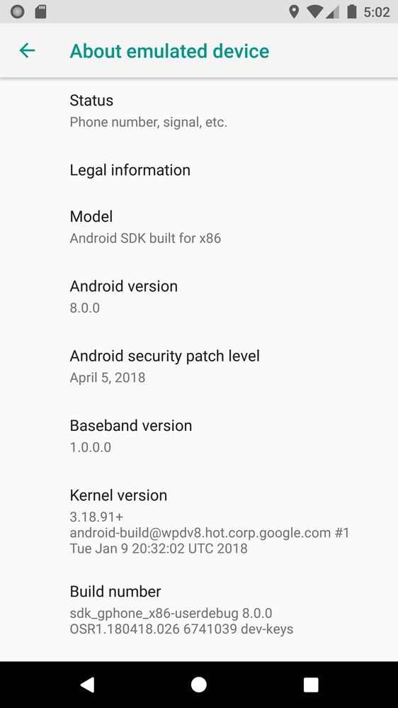

Whats the CPU architecture of the emulator?  Do you see it on any physical devices as well?
I just tried a API 26 x86 emulator which rendered the scene fine.device-details.pngdevice-scene.png
