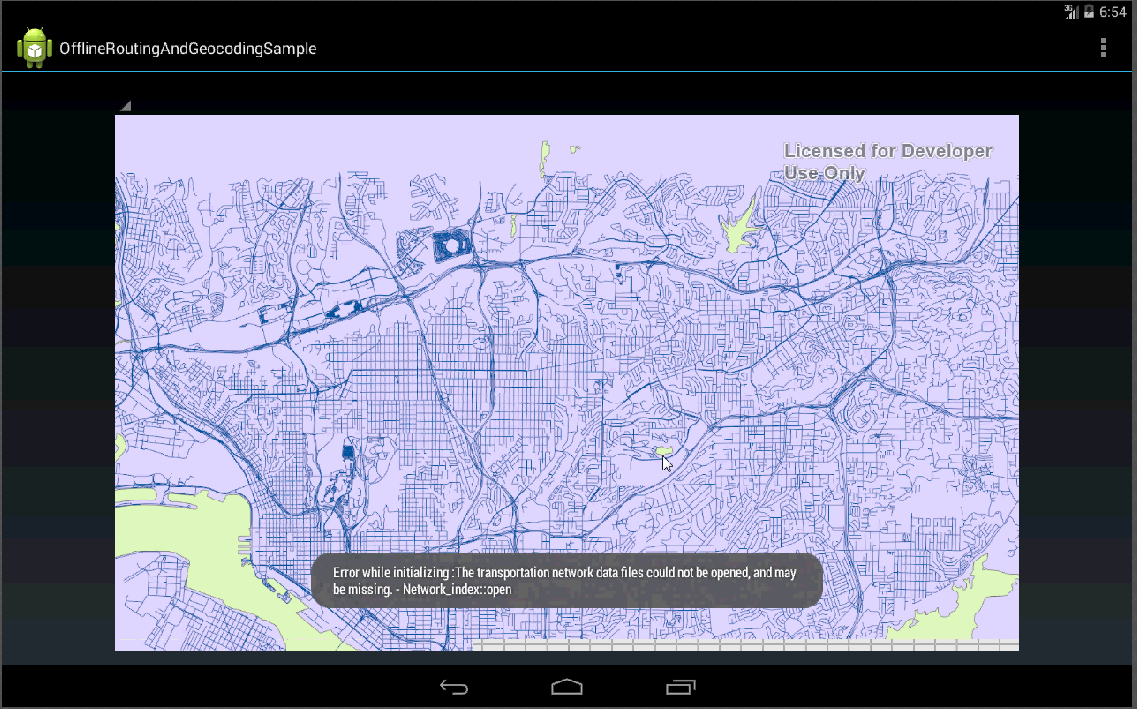

i have a question, im trying to practicing on how to prepare data for offline routing use, using ArcGIS Runtimw SDK for Android, Eclipse, and San Diego Street Network basemap TPK>> the problem is after i follow the steps and configured my Android Virtual device and push all the requeried file to their mentioned destination i have the following error note: Route Task uninitialized also the one appeared in the attached img
i don't know what to do ? i will appreciate any help or hint

it was my fault, because i push the network data to the virtual device sdcard separated, so the solution once you push the entire XXX.tn to the sdcard and deploy it to your device it works 100%
Thanks to Esri and to you all,,
