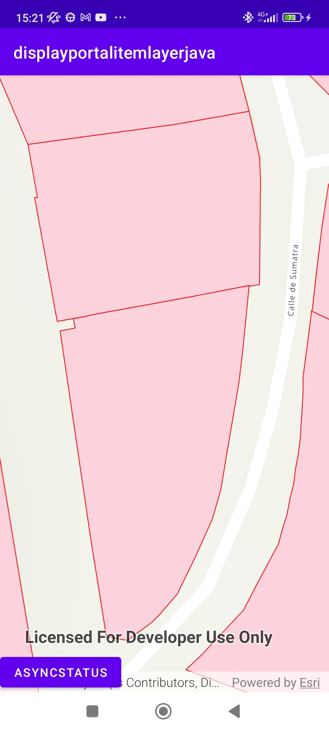

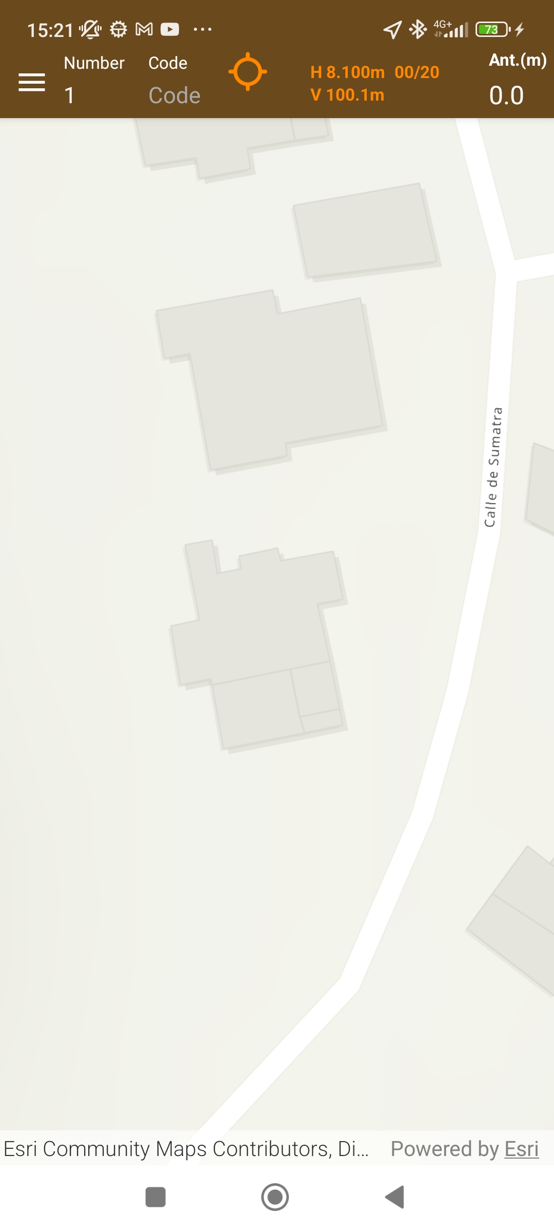

I've got the same piece of code in two apps.
In the test app, the portalItem is shown.
In the main app I'm working on, it is not. Other operational layers like WMS are in fact shown.

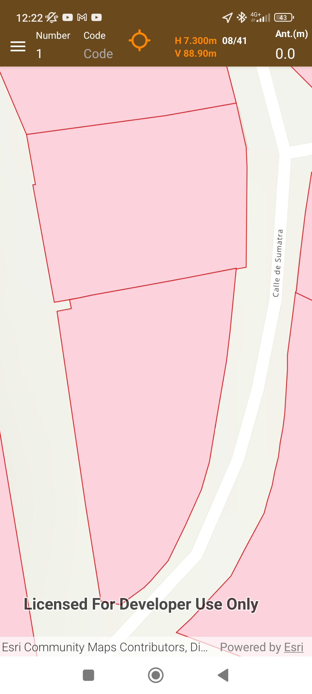

UPDATE EDIT:
It would seem that the license did make more of an effect than I thought. It is still weird. I have a separate map that I made, isolated, and with the development API KEY, it does work, as opposed with my LITE license. I do not understand, as I was under the impression that the LITE license would work with most of PortalItem's and FeatureLayer's methods.

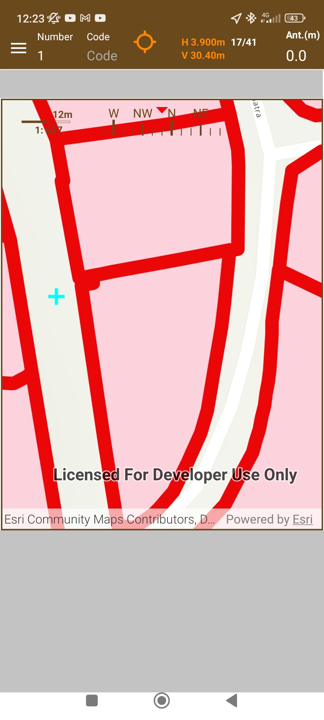

Thing is, after I've loaded and drawn the PortalItem FeatureLayer, after I go to the app's "main map", it is drawn, but with really thick lines.
I do not know why I need to draw it into a different map, before getting drawn again. Further ideas and clarifications would be welcome.

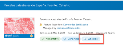

Nicholas-Furness
Hi.
Yeah, not all Living Atlas content is completely free. You can see from the details page of the item in question, that it's "Subscriber" content.
You can learn more about what that means here, but the short of it is that you'll need to authenticate to use it. It won't cost you any credits to access, but there are some items of content that for various reasons we cannot just open up publicly. You should be able to use a user-based or app-based OAuth token.
