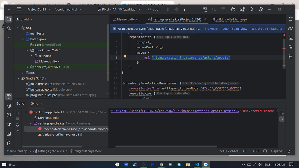

Hello,
I am experiencing an issue with my build.gradle.kts file for my project, and I would appreciate your assistance in resolving this problem. When I add settings for a Maven repository in the build.gradle.kts file as follows:
```kotlin
pluginManagement {
repositories {
google()
mavenCentral()
maven {
url 'https://esri.jfrog.io/artifactory/arcgis'
I encounter an error that says "Unexpected tokens (use ';' to separate expressions on the same line)".
I have searched online and attempted to understand the reason behind this error, but I have not been successful in resolving the issue.
Could you please help me examine the code and provide any suggestions or guidance to resolve this error?
I have attached the complete code for the build.gradle.kts file of my project for your reference:
```kotlin
dependencyResolutionManagement {
repositoriesMode.set(RepositoriesMode.FAIL_ON_PROJECT_REPOS)
repositories {
google()
mavenCentral()
rootProject.name = "ProjectCol24"
include(":app")
Thank you in advance for your assistance.
