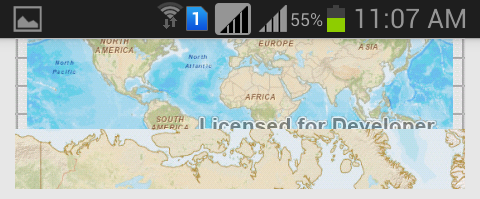

Only the MapView is working for the fragment which is loaded first. Other Fragment's MapViews (when initiated) are just showing the blocked reflection of initiated MapView (of firstly loaded fragment) but its basemap layer is working in the area of actionbar. And when I get my app's resume state back after having its pause the MapView of the other fragment (top fragment of back stack) is working fine as it should be.

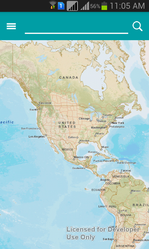

FirstFragment (First screen which is working fine)

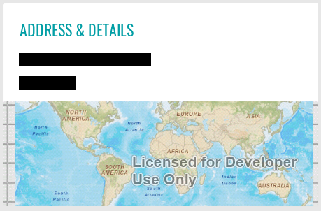

FragmentTwo (On scroll it is showing blocked reflection of FirstFragment's MapView )
FragmentTwo (In action bar area it is giving its basemap layer with scrolling motion when we scroll FragmentTwo Up and down and also this layer is working fine as FragmentTwo's mapview should be)

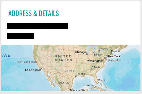

FragmentTwo (After pausing application and resume again to FragmentTwo the mapview is working fine as it should be)
