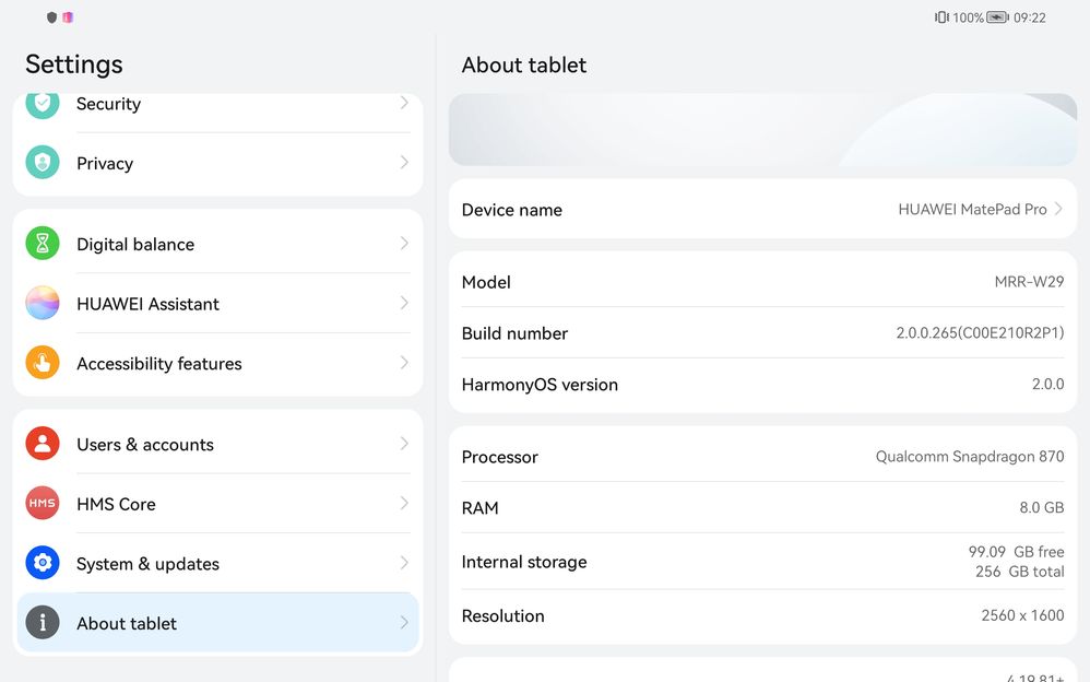

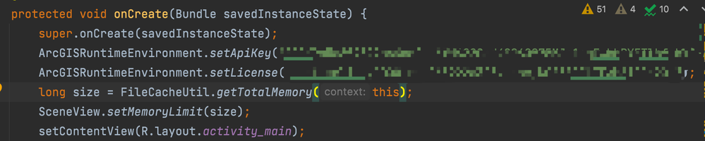

LiChunfeng
I use setMemoryLimit with device's maximum memory as follows,but still crashed.
QQ20220901-091919@2x.png[email protected]
This is the device's specifics:
Screenshot_20220901_092226_com.android.settings.jpgScreenshot_20220901_092226_com.android.settings.jpg
KoushikHajra
Thank you for your response and sharing the device details. I was hoping that it's memory related but doesn't appear to be so.
Is it possible to share some data with us? Without that it's difficult to know why it's crashing.
Also, if you have access to ArcGIS Pro, does it work there if you try to load it in that system?

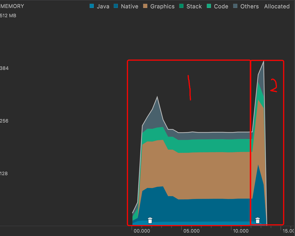

LiChunfeng
It's a memory analysis chart with profiler. The first part is the case of loading a 2D map with mapView, the second part is the case of switching to loading a 3D map with scenceViewQQ20220908-090426@2x.png[email protected]
