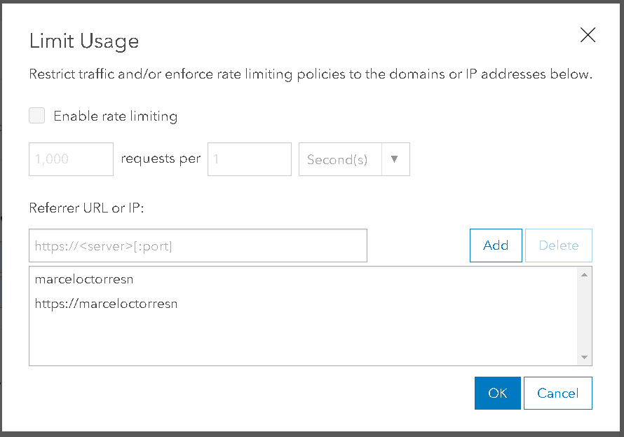

Attending customer requirements about security and limitations of access, I have to add Limit Usage to the Feature Layer:
And I have to change the code to add Referer Header to the request:
