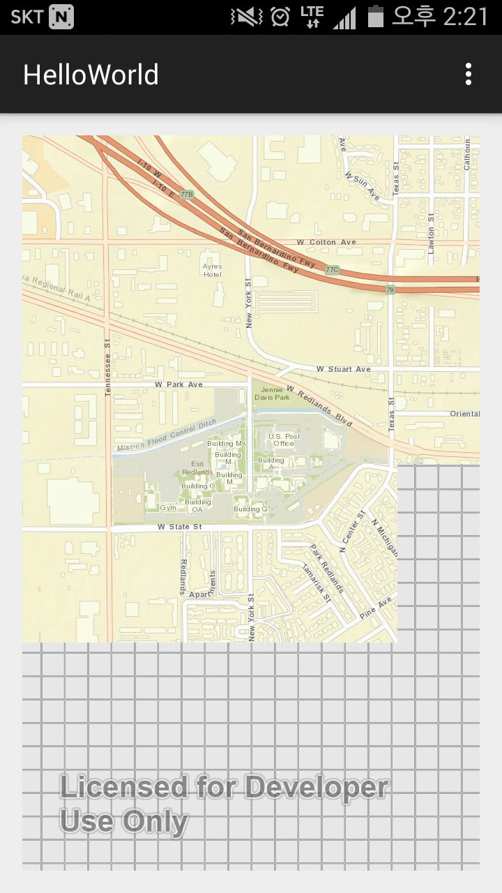

How can I solve this Problem in Android Studio
DanO_Neill
Deactivated User
Looks like you ran this sample with the emulator? Specifically the x86 emulator?  We have a known issue with respect to using our AAR SDK bundle with x86 emulators.  From our release notes:
> x86 native *.so files bundled in AAR do not work on android stock x86

JisungKim
Deactivated User
O Dan. Thanks...
It Surey Works!!!!
I don't know why it doesn't work in emulator exactly...
But it works in physical Device....
Thanks again, Your coorporation is highly appreciated..!!
