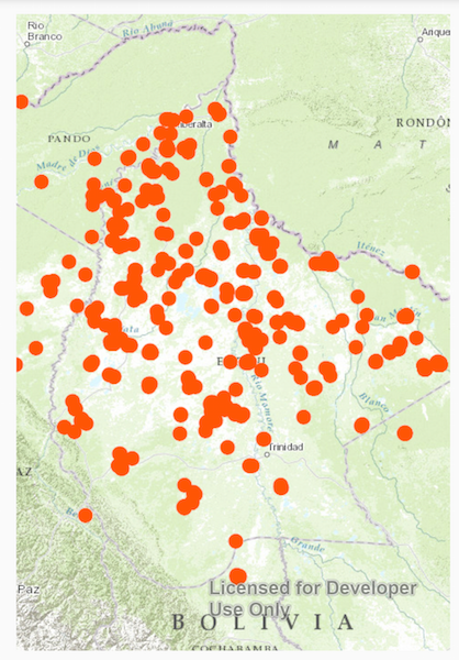

Your Map Service of Points is a dynamic layer so you need to add it in as an ArcGISDynamicMapServiceLayer.  A better sample app to get started with is the Hello World sample.  You can add your layer to this app by adding the following code snippet to MainActivity.java​:
mMapView = (MapView)findViewById(R.id.map);
// add the following code below
ArcGISDynamicMapServiceLayer pointLayer = new ArcGISDynamicMapServiceLayer("http://190.181.6.106:6080/arcgis/rest/services/Sob/FC_APP/MapServer");
mMapView.addLayer(pointLayer);
Next update the MapView layout resource, activity_main.xml, to your area of interest with the following:
mapoptions.center="-13.894009, -64.962861"
mapoptions.ZoomLevel="10"
Your map should look similar to the following screenshot:
