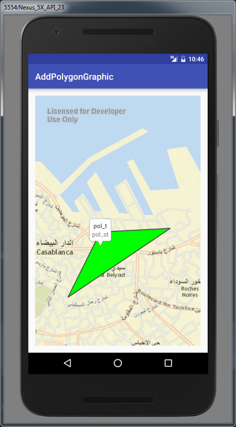

I was able to get the feature to draw in Casablanca using the following snippet:
package com.arcgis.androidsupportcases.addpolygongraphic;
import android.graphics.Color;
import android.support.v7.app.AppCompatActivity;
import android.os.Bundle;
import android.util.Log;
import com.esri.android.map.MapView;
import com.esri.android.map.event.OnStatusChangedListener;
import com.esri.android.toolkit.map.MapViewHelper;
public class MainActivity extends AppCompatActivity {
  MapView mapView;
  @Override protected void onCreate(Bundle savedInstanceState) {
   super.onCreate(savedInstanceState);
   setContentView(R.layout.activity_main);
   mapView = (MapView) findViewById(R.id.map);
   mapView.setOnStatusChangedListener(new OnStatusChangedListener() {
   @Override public void onStatusChanged(Object o, STATUS status) {
   if (status == STATUS.INITIALIZED) {
  MapViewHelper mapViewHelper = new MapViewHelper(mapView);
  double[][] latLon = new double[][] {{
   33.599389, -7.610728
   33.599985, -7.597180
   33.588879, -7.617027
  int graphic = mapViewHelper.addPolygonGraphic(latLon,"pol_t", "pol_st", "", Color.GREEN, Color.DKGRAY,2, 0);
   Log.e("NOHE", "" + graphic);
Here is the screenshot of my end result:
